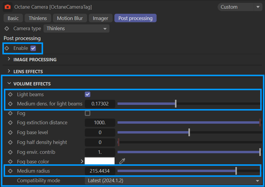

All Octane Lights can use Analytics, but only the Rectangle and Disc-shapes can actually be used to create light beams (with Post Effects). Analytic fog can be used in place of Octane volumes for fog effects, but without any actual light contribution to the scene. Note that these are post effects, and require post effects to be enabled in Octane Camera Tag > Post Processing tab.

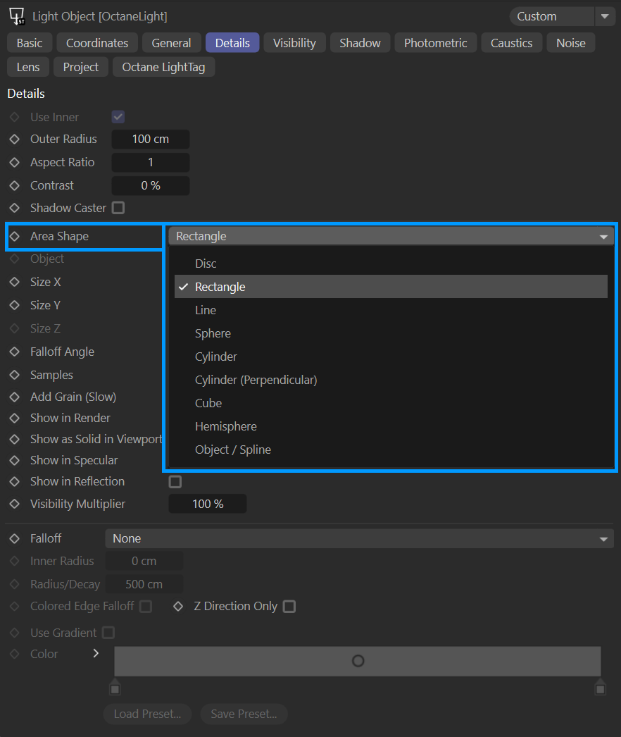

Analytic Light shapes
Like normal Octane lights, Analytic Lights derive their shape from the Area Shape menu in the Details tab of the Light Object Attributes.
Analytic light shapes
The following shapes are supported (any selection not in this list is not supported):
    • Rectangle — This option can emit Light Beams
    • Disc — This option can emit Light Beams
    • Sphere — This option cannot emit Light Beams
    • Tube — This option cannot emit Light Beams

To enable Volumetric Fog, click on Fog Enable in the Volume Effects subsection in the Octane Camera tag > Post Processing tab.
volumetric Light Beams
Analytic lights can be used to create visible light cones as a post-process — these lights resolve almost instantaneously and are noise-free. Analytic Lights must be enabled in the Octane Light tag > Light Type menu, and Volumetric Light Beams enabled via the Light Beams toggle in the Volume Effects subsection of the Octane Camera tag > Post Processing tab. Adjust the Medium Density for Light Beams to make the beams weaker or stronger. The Medium Radius controls the extent of visibility for Light Beams.
