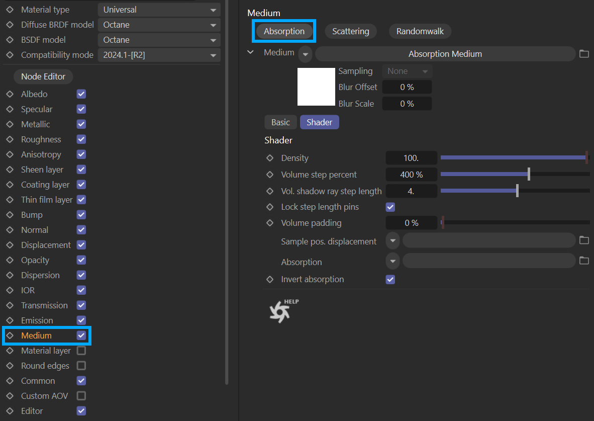

In OctaneRender®, some material types contain a Medium channel. The medium channel is where the process of absorption is accounted for in a rendering. To add a medium into an Octane material, enable the Medium toggle, as illustrated below. When you select the Medium tab of the material, you will see three buttons, each with the name of a Medium. The options of the absorption medium will appear after you click on the button, as shown.
absorption medium

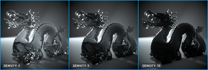

This parameter increases the absorption (and scatter) texture density by multiplying it. You can change this value depending on the material type you'll create. For example, if you are going to make a candle, you may increase this value. This parameter works in cooperation with other options — you can use it alone, but when you start to create complex materials, you will see that all the options are tightly bound together. The default value is 100, but this value should not be taken as a reference. The following picture shows various density settings. You can think of Density as the number of particles in a medium. If there is no particle, there is no absorption and most importantly no scattering.
absorption medium — density

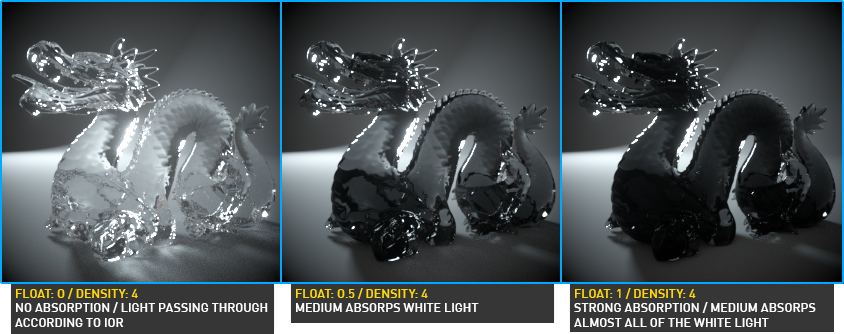

A value of 0 (black) indicates no absorption. Values greater than 0 represent how quickly the medium absorbs white light. In the image below, absorption results from different float values are presented. Remember, the density value is also taken into consideration. The use of FloatTexture value in this illustration is between 0 and 1, but this value can be increased to whatever is needed by directly entering the desired value into the slider edit box.
absorption — grayscale texture

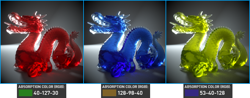

The absorption color can be specified using RGB values. By default, the color in the Absorption slot will be the same as the color that you see. However, this result is not physically correct and was implemented for simplicity. The illustration below uses an RGB spectrum node in the texture slot and the Invert Absorption value disabled, which is physically correct — the color that is absorbed and the color that is observed will be different — the observed color is the complementary color (opposite color) of the color value in the texture slot. In the examples below you can see the result of various colors after "absorbed color". The density value is 20 for all samples, the roughness value is 0.02 and the Index value is 1.3. Specular was used as material.
absorption — RGB texture
