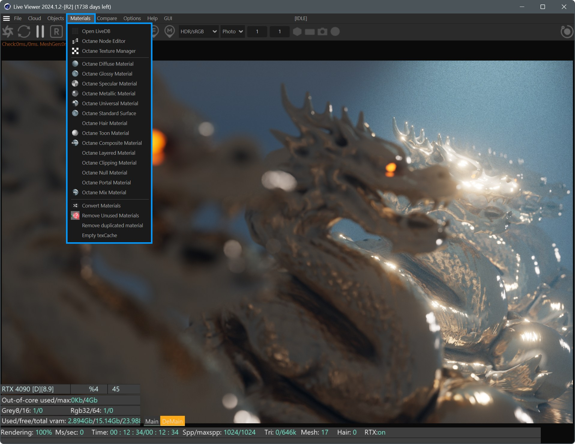

create materials from the Live Viewer
Go to Live Viewer > Materials and pick the material type from the menu list. A material thumbnail will appear in Cinema 4D's material editor window. Double-click on it to get to the Material Editor.
accessing materials
