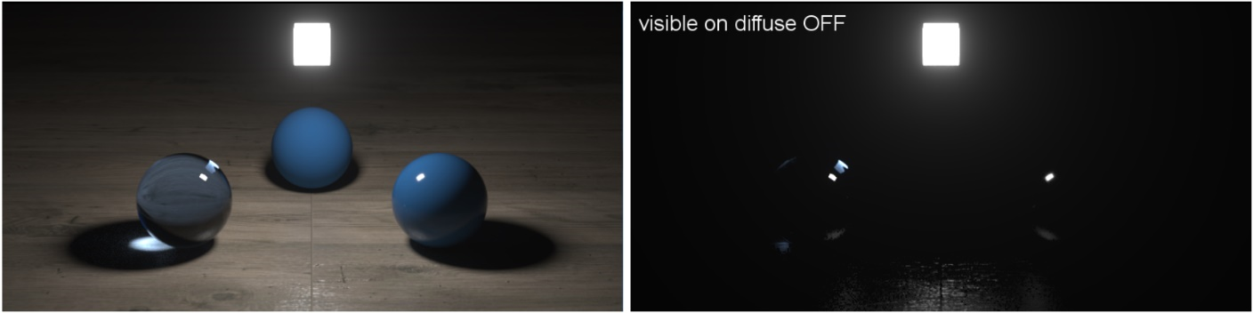

Visible On Diffuse - Makes the light source visible on diffuse surfaces. This is enabled by default. This allows you to enable or disable the Black Body emission or Texture emission light sources from casting illumination or shadows on Diffuse objects. Disabling this option disables Emission, meaning it's visible in diffuse reflections, but is still be visible in specular reflections. It's also excluded from the direct light calculation.
 | Texture Emission
Figure 4: The Visible On Diffuse parameter when enabled and disabled
