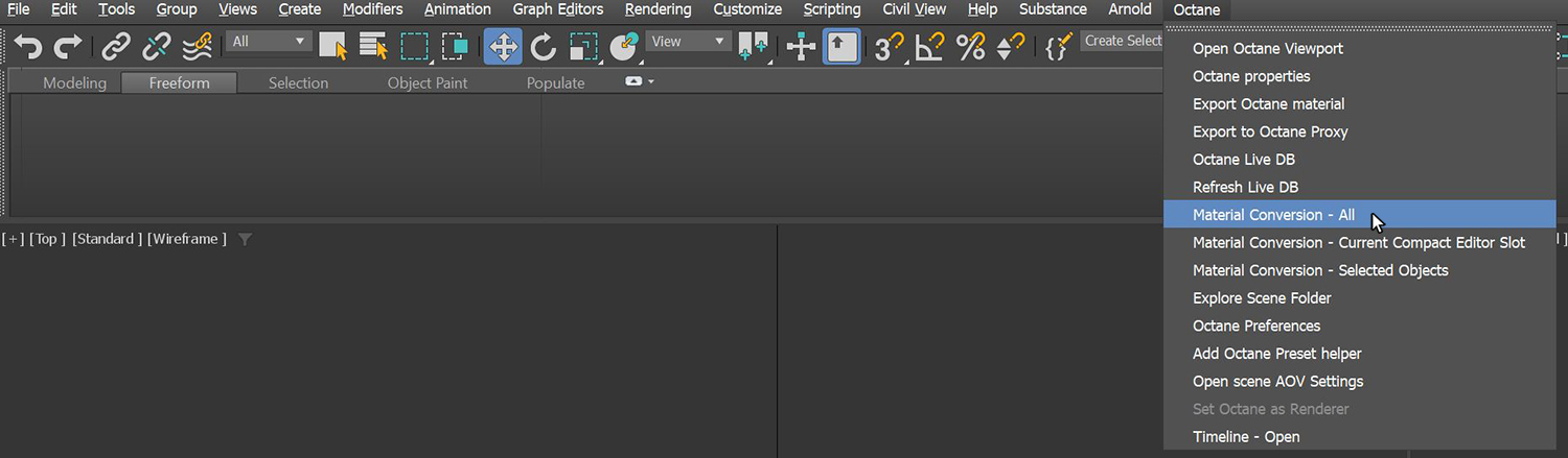

There may be situations where you need to convert Materials from other render engines to OctaneRender® materials in order for the materials to render in OctaneRender for 3ds Max®. To do this, click on the Octane menu, then click on the Material Conversion - All menu item (Figure 1). You can also go to the Render Setup window, then click on the Tools tab, followed by clicking on the Material Converter rollout, then clicking the Convert All button (Figure 2).

Figure 1: Using the Material Conversion - All to convert other materials and light sources to OctaneRender
