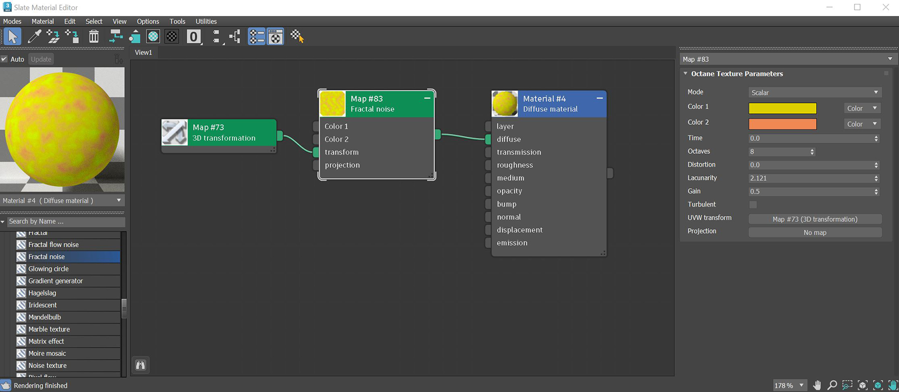

The Fractal node produces an organic pattern based on fractal equations (figure 1).
Octane Logo
Fractal Noise
Fractal Noise Fig01 3dsmax v2023
Figure 1: The Fractal node and it's associated parameters
Fractal Noise Parameters
Mode - Specifies whether scalar or vector mode is used to calculate the fractal noise.
Colors 1 & 2 - Specifies the two colors used to generate the fractal noise.
Time - Shifts the fractal pattern over time.
Octaves - Specifies the multiple frequencies in which the fractal pattern is repeated.
Distortion - Determines the scale of random displacement applied to the fractal pattern.
Lacunarity - Controls the size of the space in the fractal texture pattern.
Gain - An amplitude multiplier per iteration where higher values will result in a flatter pattern.
Turbulent - Adds an additional layer of noise to the fractal pattern.
UVW Transform - Positions, scales, and rotates the surface texture.
Projection - Sets how the texture projects onto the surface.
